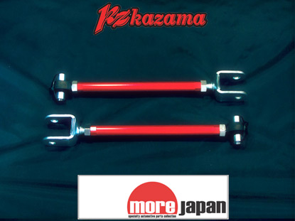

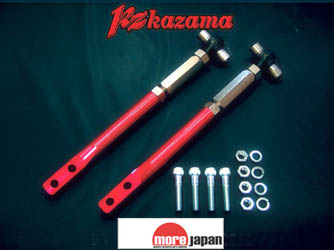

Changing the rear upper control
arms on the 240SX to a unit like the Kazama
Auto RUCA can adjust rear camber. Pillowball
mounts with camber adjustments can be used
for front settings.

All too often on the 240SX, the
stock bushing type TC rods are worn out and
shot, causing independent caster movement of
the front suspension. This can cause the car
to pull to one side, especially during
braking. Replacing with stronger units is a
common upgrade on the 240SX.

Changing the Rear Toe Rod can
reduce rear steer and instability on
extremely worn rear suspensions. Since rear
camber and toe settings directly affect each
other, it is wise to upgrade both the rear
camber arm and toe rod at the same time.
